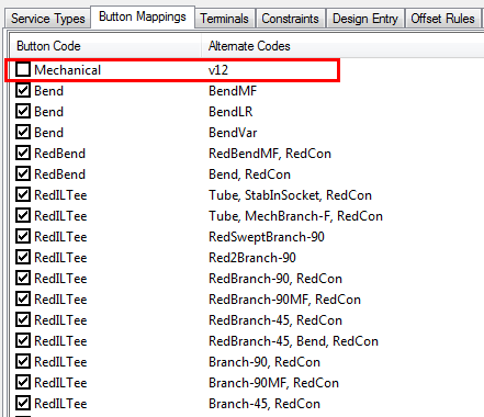

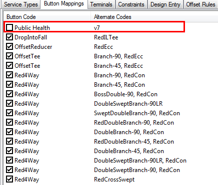

Below are examples of button mappings of mechanical and drainage systems.
| Mechanical System Button Mappings
Drainage System Button Mappings
