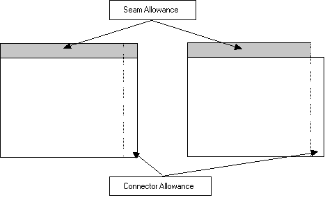

The Notches option allows the connectors that are used on rectangular ducts to be modified for the development of the ductwork that they are applied to. This is illustrated in the example below. Without the removal of the seam, the flange allowance could not be run through the same seaming procedure as the rest of the seam.

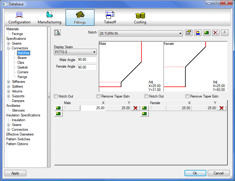

Notches cannot be applied to a development directly. To apply a notch you must first associate it with a connector. Notches are configured from the notches dialog in the pattern database.

Display Seam: Allows the user to change the seam that is displayed in the notch preview windows. This does not have a direct effect on the notch, but is useful for visualising the notch when in the creation process. The list of seams is taken from the seam database.

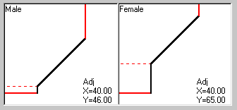

Male Angle: Sets the angle to which the male seam will be cut.
Female Angle: Sets the angle to which the female seam will be cut
Notch (Pulldown Menu)
: Displays a list of the currently configured notches. It is inadvisable to change any of the pre-defined notches if you are not sure where they are used. It is safer to create a new notch as there are no limits to the number of new notches that can be created. To create a new notch, click the
icon to the right of the pull-down menu. You will be asked if you want to copy the settings from the currently selected notch. If this notch is similar to the one you want to create, click Yes. If you want to start from scratch, click No. Click
to delete a notch. The
Icon is used to add notches to the database which have been brought in with other items. If this is applicable, then this icon displays in color (not grey) and is selectable.

Note that in the above diagram, the Y= lengths are both longer than the values you have entered in; in this case 40 for each. This is because it is adding the Y= allowance to the seam allowance, as defined under the Seams tab.

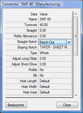

This can then be applied to a Connector using the Straight and Taper Notch fields.
