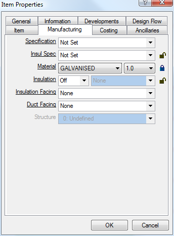

Manufacturing Tab
The properties that display on the Manufacturing tab depend on the type of item selected. For example, some items may or may not include manufacturing properties that are applicable to that part; for example, Insulation Facing, Main Facing, Air Turns, Stiffeners, or Supports, etc, depending on the item type.
The following item properties can be available on the Manufacturing tab:
Specification: When a specification is assigned, this field displays the name of the specification assigned to this item. When a specification has not been assigned, this filed is set to Not Set.
Insul Spec: If an insulation specification has been assigned, it is displayed here.
Material: Specifies the material of this item. Next to the Material drop-down is the drop-down that specifies the gauge of the material for this item, as defined in the specification that is specified here.
Insulation: Specifies whether the insulation is applied to the Inside or Outside of the item, or not at all (Off).
Insulation Facing: Specifies the insulation facing associated with this item.
Main Facing: Specifies the main facing associated with this item.
Structure: Specifies the structure associated with this item.
Airturns, Stiffeners, or Supports: These may be specified if they are applicable to the item.

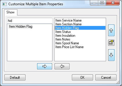

Hidden: This option lets you hide certain items from being displayed in the 3D viewer, but still include them in other aspects of the job; for example, for estimating or for reports, etc. When this option is enabled:
If desired, you can choose to display the Hidden property (Item Hidden Flag) on the Customize Multiple Item Properties dialog, as shown below.
