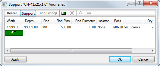

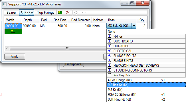

Bolt assignment can be grouped as a set quantity, as shown below, or can be broken down into individual ancillaries, and then made into an Ancillary Kit. This Slotted Channel support setup shows M8x20 Bolts being assigned as a single ancillary. The terminology used on the description of the ancillary, in this case, is to say that there is a set included. However, by using an Ancillary Kit, you can build up the makings of the set, and then use these for reporting exact quantities on the project (for example, for each Nut, Bolt and Washer quantity totals).

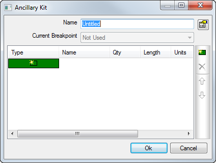

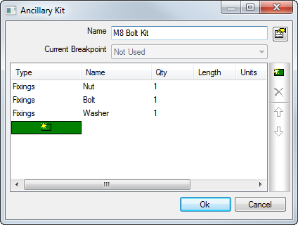

From Database Fittings Ancillaries Type of Ancillary drop-down menu, select Ancillary Kits.
All Ancillary Kits created in the database are listed here. You can create a new ancillary kit by clicking , or select an existing kit in the row, and then clicking to be prompted to create a copy of the selected one present in the database.
Specify an overall name of the kit, and then add for each ancillary, a row for each type required, as shown above. On selection of Type, the Name field then has a drop-down of the database selection of each ancillary listed. Here we have added 3 rows as Fixings types, so the Name field becomes a drop-down option of all Fixing ancillaries in the database (requirement to be created prior to selection).
Specifying each row with a quantity or length means that when the kit is used, the quantities entered here will be taken off each time. The ancillary kit, once saved, can then be applied to the required connector, support or stiffener etc. If using the length field, ensure the ancillary used has a cost per meter.
All created ancillary kits become available for selection under the Ancillary Kits subsection.

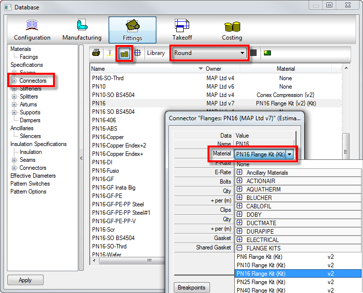

From the Connector Database (Database Fittings Connectors), accessing the Costing icon for Round Connectors , allows assignment of ancillary kit to the material section. Double clicking the Connector opens up the dialog for assigning the newly created kit. The Material section calculates the periphery or circumference of the connector. The auto length from the gasket assignment in the Kit, populates this length and report the correct amount Gasket required.

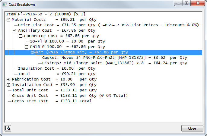

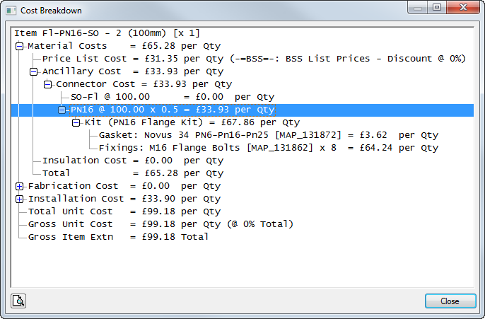

The Cost breakdown of the 100 dia PN16 flange is shown below. As this only has one connector called PN16, this will report the Ancillary Kit assigned as a quantity, but within the kit lies the Gasket and Bolts with their own quantity values.

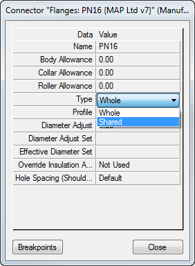

The connector PN16 from the database can be additionally setup to be Shared from the setup which will half all values assigned if using for sharing of joints.
Now when viewing the breakdown, the cost of the Kit is halved (multiplied by 0.5) at the end calculation which is used when sharing joint quantities.
