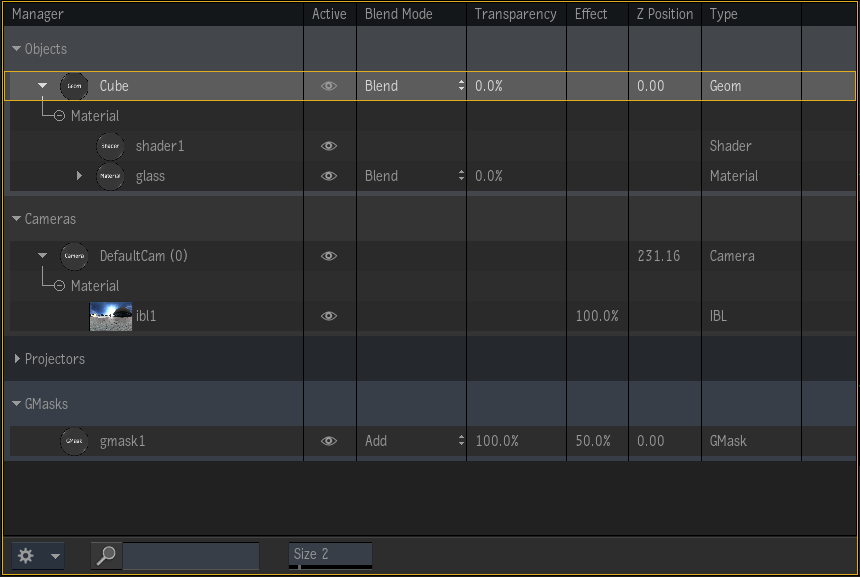

The Manager view provides you with a clear listing of all the objects found in an Action scene, organized in a hierarchy that mirrors the Action schematic. The Manager view, or Manager for short, reduces the complexity of a scene by making it easier to identify and select an object using its name.
The Action Schematic remains at the heart of Action for anything related to object connections and relationships. The Manager simplifies everything else.

From here you can manage your Action scene, add and delete objects using the contextual menu.
The Manager groups objects by how they're rendered in the scene:
If an Axis has multiple children, the Manager displays this Axis as a parent of the objects. You can collapse this Axis as a section, change its name, and select it to make it the primary selection for editing. This makes any large geometry structure much easier to navigate and manipulate.
If an object has more than one parent, that object appears under both parents.
| Column | Contents |
| Nodes | In this column nodes can be selected and renamed. Use the contextual menu to access additional operations.
Additional information such as the Matchbox Outside status, IBL Back status, Camera Index, and Stereo status are now displayed next to the node name. |
| Active | Hides or displays an object from the Rendering view.
This is the same as the Hide (H) keyboard shortcut in the Schematic. |
| Current Output | Adds or removes the object from the current output. Hidden by default.
Right-click the column headings to access it.
Works as the Edit Output function of the schematic. Editing a node out of the output also removes its parent Axis. Multi-selection is not possible. |
| Transparency | Displays the Transparency attribute of the node, when one is available.
Ctrl+clicking the Transparency field resets it. |
| Blend Mode | Displays the Blend Mode attribute of the node, when one is available. |
| Type | Type of the node (geometry, shader, material...). |
| Effect | Controls many objects' Effect or Intensity parameters. Here are a few examples:
| Z Position | Displays a node position in Z. |
