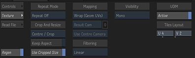

The UDIM Active option detects UDIM files and creates a single UDIM file in the browser. It indicates the number of tiles part of the UDIM texture.

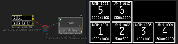

In Action, you need to tell the texture map how the tiles are distributed according to the U- and V-axis. In the above example, U = 4, and V = 2.
The Action schematic with the a cube and the UDIM texture.

Every Texture Map Texture menu has a UDIM section to apply the UDIM scaling, based on the number of tiles contained in the resulting texture. On import, if UDIM is enabled, it is set automatically to Active with the appropriate U and V values. Whether the resulting texture comes from MediaHub or Batch, you can set the U and V values for the grid, allowing the scaling to be properly applied.

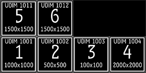

The key takeaway is that UDIM is a numbering system used to ties files to UV coordinates. The following files:
Represent the following tileset.

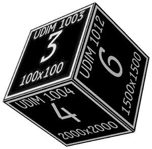

These 6 tiles can be wrapped on an FBX geometry.
But Action cannot load UDIM tiles in multiple textures. When you load a UDIM, a texture that contains all the tiles is created.
The 6 UDIM tiles got combined into a single Action texture.
The Action schematic with the FBX cube and the UDIM texture.
