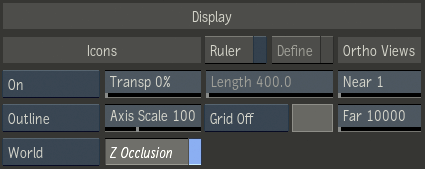

Display Settings
- Icons box
- Sets object icon (axes, borders, control points) and wireframe display options. Selected displays icons only for the object currently selected in the scene. Group Off displays every icons except for objects nested in Group nodes. Use option the Cycle Icons Draw Modes keyboard shortcut to cycle through the options.
- Icon Transparency field
- Displays the transparency level for icons and wireframes in the scene. Editable.
- Selection Highlight box
- Select the type of highlight used to identify the objects that are selected in the viewport.
- Axis Scale field
- Displays the size of axis icons in the scene. Editable.
- GMask Vertices button
- Enable to always display GMask vertices. Disable to hide the vertices of GMasks that are not selected.
- Z-depth Occlusion button
- Enable to have Z-depth occlusion affect Action widgets such as axis, light, and cameras. It creates a true 3D experience in terms of viewing, but hides occluded widgets.
- Space Selection button
- Select the space for transforms performed using a 3D Manipulator. In Object space, the manipulator sticks to the object's axis orientation, ideal for translations. In World space, the manipulator follows the World's frame of reference, ideal for rotations. In Camera space, the manipulator stays in the camera's XY plane.
- Ruler button
- Enable to display the ruler in the scene area. Use the arrows at each extremity of the ruler to place the beginning and end of the ruler anywhere in your scene view.

- Ruler Define button
- Enable to define real unit measurements, such as feet, metres, or inches, instead of pixels. All camera distance or axes measurements thereafter use the defined scale.
- Ruler Length field
- Displays the length and measuring unit (feet, metres) to use in Action. When you enter a length, click Define again to apply the new scale to the ruler and all pertinent fields, such as position, rotation, and scale. Editable.

- Grid box
- Select the type of grid to display in the scene. Use to position objects in the scene more accurately.
| Select:
To:
| Grid Off
Disable the grid.
| Grid XY
Use a grid constructed on the X and Y planes.
| Grid XZ
Use a grid constructed on the X and Z planes. The XZ grid is visible only when the camera is moved from its default position.
| Grid YZ
Use a grid constructed on the Y and Z planes. The YZ grid is visible only when the camera is moved from its default position.
Note: The Action grid is independent from the global grid in the Grids and Guides menu.
- Grid Colour pot
- Displays the custom colour for the grid. Editable.
- Ortho Near field
- Displays the value of the near view in the image window when using Camera or an orthographic view. Editable.
- Ortho Far field
- Displays the value of the far view in the image window when using Camera or an orthographic view. Editable.
