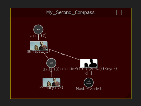

The Compass node is a node you use to define and identify an area in the Action schematic.
Adding the Compass node to the schematic creates a box that you can resize and place over the nodes you want it to encompass. The nodes in the Compass are automatically selected when you click on the Compass header, and all the nodes included in the Compass will follow when you move the Compass. The Compass node makes it easier to manage your Action schematic and scene, particularly if it is very large.

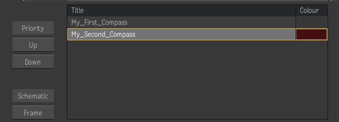

The Compass menu, which appears when a Compass node is selected in the schematic, contains a table that enables you to sort the different compasses in Z space, using the Up and Down buttons. You can also assign a colour to each Compass object in the schematic. The default colour is grey.
Once a Compass node is added to the schematic, the naming field, in its header, is immediately activated.
You can rename a Compass node by clicking on the selected item name within the Compass menu table.
Compass nodes can be resized by selecting a corner or an edge of the box and dragging to the desired size.
You can frame a Compass to the center of the schematic by selecting it in the Compass menu table and clicking the Frame button, on the bottom left. This is also achieved by double-clicking a Compass node entry in the Compass menu table.
