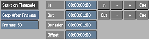

Besides the described methods of entering timecodes in the In, Out, and Dur fields, you can modify clip in and out points or cue the VTR to these points using the following controls on the right side of the Input or Output menu.
In button
Click to set the In field to the VTR's current timecode.
Out button
Click to set the Out field to the VTR's current timecode.
+ and - buttons
Click to frame-step the In or Out timecodes forward or backward. If Stop After Frames is selected from the Stop Mode box, both the in and out points move because the duration between them is locked.
Cue buttons
Click to cue the VTR to the in or out point.
