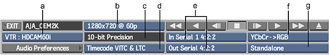

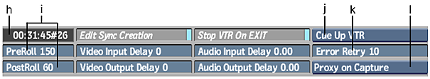

Consult the following illustration (broken into three parts) and explanations of the options in the Engineering menu. These illustrations are of the VTR Input Engineering menu. The VTR Clip Engineering menu contains a subset of these controls.
(a) Device Name box  (b) Video I/O Timing box  (c) Precision box  (d) Timecode Source box  (e) Input and Output Connection boxes  (f) Colour Space box  (g) Output Sync box   (h) VTR Current Timecode field  (i) PreRoll/PostRoll fields  (j) Cue Up box  (k) Error Retry field  (l) Proxy Box
Device name box
The Device Name box differentiates between 3G and non-3G capable VTR and provides an option for each enabled VTR. To modify settings for a specific VTR device, select the corresponding option from this box.
Provides video timing options (resolution and frame rate) corresponding to different video formats supported by the video input/output board of the system.
Precision box
Determines the video interface precision, or SDI bit depth used. This value cannot be changed.
Audio Preferences button
Click to view the Audio Preferences menu.
Timecode Source box
Determines which type of timecode is obtained from the VTR device. Timecode VITC & LTC is the default, and recommended option. You should only have to switch to Timecode VITC or Timecode LTC if one of the timecode tracks is corrupted.
These boxes determine the connection by which the video signal is transferred. This box is automatically set to reflect the selected VTR.
  • In Serial 1 3G / Out serial 1 3G: The video signal is transferred through one SDI 3G link. This is the only available option when you use a 3G VTR. The VTR Status field indicates any conversion that might happen because of the sampling used, 4:2:2 (conversion YCbCr <-> RGB) or 4:4:4 (no conversion RGB <-> RGB).

Colour Space box
Determines the YCrCb colour space conversion method.

Output Sync box
Determines the output sync reference source. The reference signal may originate from several different sources. Select the source you are using from this box according to the following table.

PreRoll field
Indicates the pre-roll, in frames.
PostRoll field
Indicates the post-roll, in frames.
Video Input Delay field
Indicates the video delay on input, in frames. If this value is incorrect, the result clip when you click Frame Grab in the VTR Input module does not match the frame you see in the preview window.
Video Output Delay field
Indicates the video delay on output, in frames. If this value is incorrect, the clip you output does not get recorded to the proper place on the tape.

Cue Up box
Determines the speed of the cueing process.

Error Retry field
Indicates the number of times Flame retries failed input or output processes.

Proxy box
Determines proxy management when inputting clips.
