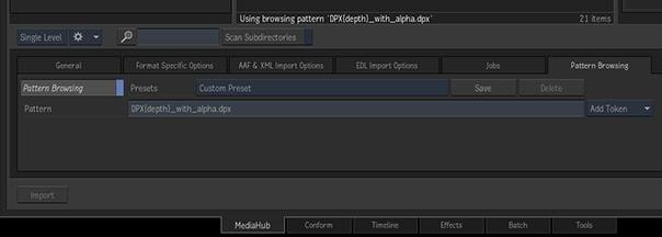

By accessing the Pattern Browsing tab in MediaHub, you can browse content using patterns similar to the ones used to create patterned Open Clips.
In previous releases, you could create an Open Clip to build a multi-channel clip out of multiple files, or create versions out of multiple clips. But now you can do the same without first creating an Open Clip. These clips are then automatically updated when new versions matching the pattern are available on the file system.
Tokens can be used to match file names or folders. You can use pre-defined tokens, or your own custom tokens.
Clips matching the defined patterned are seen with V or Multi icon, based on the pattern. Also, MediaHub status bar displays the current pattern used to browse when Pattern Browsing is enabled. That way, you know MediaHub uses Pattern Browsing to display content.
From the Browsing Pattern tab, you can also create and manage shared presets. As with any MediaHub setting, these options are saved with the project.
