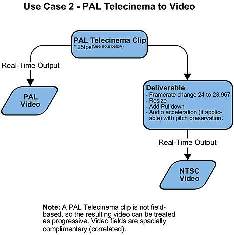

In this example, NTSC and PAL video are output, but the source material is a PAL Telecinema clip. Because a PAL Telecinema clip is not field-based, the resulting video can be treated as progressive. Its video fields are spatially complementary.
To output to PAL video, you would not need to create a Deliverable. You can output the clip directly to tape from the Output Clip menu.
To output to NTSC video, you would create a Deliverable that does the following:
From the Clip Output menu, the clip is output to tape with no need to render the preceding settings.
