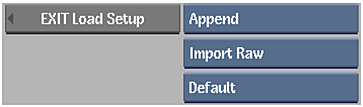

To import a raw setup file:
- In the Garbage Mask menu, click Load to open the file browser.
- From the GMask Type box, select Import RAW.
- Navigate to the appropriate directory and select the raw setup file to import.
The raw setup file is imported into the Keyer.
To import a raw setup file in the Modular Keyer:
- In the Modular Keyer, click the GMask node in the processing pipeline.
- In the GMask menu, click Load.
The Load menu and file browser appear.
- In the Load menu, select Import Raw and Default from the Load option boxes.
- Enable Append or Replace.
- In the file browser, specify the name and path of the file to import.

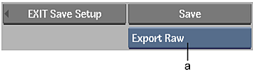

To export a raw setup file in the Modular Keyer:
- In the GMask Setup menu, click Save.
The Save menu and file browser appear.
(a) Save option box
- In the Save menu, select Export Raw from the Save option box.
- In the file browser, specify the name and path of the file to export.
- Click Save.
