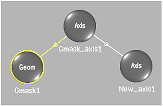

To apply axis motion blur:
The garbage mask and the new axis should now both be parented to the garbage mask axis.
Motion blur is applied to the stationary garbage mask.
