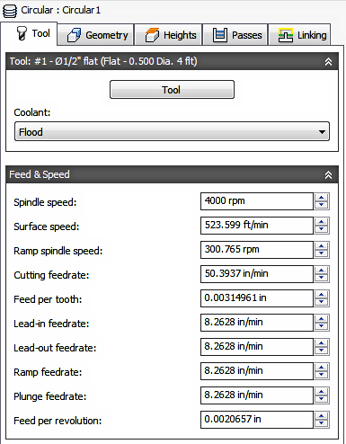

Tool tab settings
Coolant
Select the type of coolant used with the machine tool. Not all types will work with all machine postprocessors.
Feed & Speed
Spindle and Feedrate cutting parameters.
- Spindle Speed - The rotational speed of the spindle expressed in Rotations Per Minute (RPM)
- Surface Speed - The speed which the material moves past the cutting edge of the tool (SFM or m/min)
- Ramp Spindle Speed - The rotational speed of the spindle when performing ramp movements
- Cutting Feedrate - Feedrate used in regular cutting moves. Expressed as Inches/Min (IPM) or MM/Min
- Feed per Tooth - The cutting feedrate expressed as the feed per tooth (FPT)
- Lead-In Feedrate - Feed used when leading in to a cutting move.
- Lead-Out Feedrate - Feed used when leading out from a cutting move
- Ramp Feedrate - Feed used when doing helical ramps into stock
- Plunge Feedrate - Feed used when plunging into stock
- Feed per Revolution - The plunge feedrate expressed as the feed per revolution

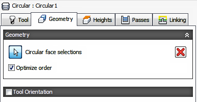

Geometry tab settings
Geometry
Select any cylindrical holes, pockets or bosses. Only Face selections are allowed.
Part with no selections.
Hole Face and circular pocket Face selection.
Optimize Order
Enable to order the selected Faces for the shortest distance between cuts
Tool Orientation
Not available in
Inventor CAM Express
Specifies how the tool orientation is determined using a combination of triad orientation and origin options.
The
Orientation drop-down menu provides the following options to set the orientation of the X, Y, and Z triad axes:
Setup WCS orientation - Uses the workpiece coordinate system (WCS) of the current setup for the tool orientation.
Model orientation - Uses the coordinate system (WCS) of the current part for the tool orientation.
Select Z axis/plane & X axis - Select a face or an edge to define the Z axis and another face or edge to define the X axis. Both the Z and X axes can be flipped 180 degrees.
Select Z axis/plane & Y axis - Select a face or an edge to define the Z axis and another face or edge to define the Y axis. Both the Z and Y axes can be flipped 180 degrees.
Select X & Y axes - Select a face or an edge to define the X axis and another face or edge to define the Y axis. Both the X and Y axes can be flipped 180 degrees.
Select coordinate system - Sets a specific tool orientation for this operation from a defined user coordinate system in the model. This uses both the origin and orientation of the existing coordinate system.
Use this if your model does not contain a suitable point & plane for your operation.
The
Origin drop-down menu offers the following options for locating the triad origin:
Setup WCS origin - Uses the workpiece coordinate system (WCS) origin of the current setup for the tool origin.
- Model origin - Uses the coordinate system (WCS) origin of the current part for the tool origin.
Selected point - Select a vertex or an edge for the triad origin.
Stock box point - Select a point on the stock bounding box for the triad origin.
Model box point - Select a point on the model bounding box for the triad origin.

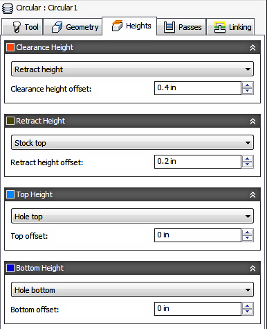

Heights tab settings
Clearance Height
The Clearance height is the first height the tool rapids to on its way to the start of the tool path.
Clearance Height
Retract height: incremental offset from the
Retract Height.
Top height: incremental offset from the
Top Height.
Bottom height: incremental offset from the
Bottom Height.
Model top: incremental offset from the
Model Top.
Model bottom: incremental offset from the
Model Bottom.
Stock top: incremental offset from the
Stock Top.
Stock bottom: incremental offset from the
Stock Bottom.
Hole top: incremental offset from the
Hole Top.
Hole bottom: incremental offset from the
Hole Bottom.
Selection: incremental offset from a
Point (vertex),
Edge or
Face selected on the model.
Origin (absolute): absolute offset from the
Origin that is defined in either the
Setup or in
Tool Orientation within the specific operation.
Clearance height offset:
The
Clearance height offset is applied and is relative to the Clearance height selection in the above drop-down list.
Retract Height
Retract height sets the height that the tool moves up to before the next cutting pass. Retract height should be set above the
Feed height and
Top. Retract height is used together with the subsequent offset to establish the height.
Retract Height
Clearance height: incremental offset from the
Clearance Height.
Top Height.
Bottom Height.
Model Top.
Model Bottom.
Stock Top.
Stock Bottom.
Hole Top.
Hole Bottom.
Point (vertex),
Edge or
Setup or in
Retract height offset:
Retract height offset is applied and is relative to the Retract height selection in the above drop-down list.
Top Height
Top height sets the height that describes the top of the cut. Top height should be set above the
Bottom. Top height is used together with the subsequent offset to establish the height.
Top Height
Clearance Height.
Retract Height.
Bottom Height.
Model Top.
Model Bottom.
Stock Top.
Stock Bottom.
Hole Top.
Hole Bottom.
Point (vertex),
Edge or
Setup or in
Top offset:
Top offset is applied and is relative to the Top height selection in the above drop-down list.
Bottom Height
Bottom height determines the final machining height/depth and the lowest depth that the tool descends into the stock. Bottom height needs to be set below the
Top. Bottom height is used together with the subsequent offset to establish the height.
Bottom Height
Clearance Height.
Retract Height.
Top Height.
Model Top.
Model Bottom.
Stock Top.
Stock Bottom.
Hole Top.
Hole Bottom.
Point (vertex),
Edge or
Setup or in
Bottom offset:
Bottom offset is applied and is relative to the Bottom height selection in the above drop-down list.

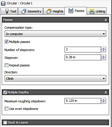

Passes tab settings
Compensation type:
Specifies the compensation type.
- In computer - Tool compensation is calculated automatically by
Inventor CAM based on the selected tool diameter. The post processed output contains the compensated path directly, instead of G41/G42 codes.
- In control - Tool compensation is not calculated, but rather G41/G42 codes are output to allow the operator to set the compensation amount and wear on the machine tool control.
- Wear - Works as if
In computer was selected, but also outputs the G41/G42 codes. This lets the machine tool operator adjust for tool wear at the machine tool control by entering the difference in tool size as a negative number.
- Inverse wear - Identical to the
Wear option, except that the wear adjustment is entered as a positive number.
Note: Control compensation (including
Wear and
Inverse wear) is only done on finishing passes.
Multiple Passes
Enable to make multiple cuts in the XY plane.
Shown with a single pass
and Lead to Center disabled.
Shown with 2 passes of .280 in.
and Lead to Center enabled.
Number of stepovers:
The number of roughing steps.
Stepover
Specifies XY stepover distance between passes. By default, this value is 95% of the cutter diameter less the tool corner radius.
XY Stepover
Repeat passes
Enable to perform the final finishing pass twice to remove stock left due to tool deflection.
Direction
This setting determines the side of the toolpath from which the tool center is offset. Choose between
Climb milling sideways compensation or
Conventional milling sideways compensation.
Left (climb milling)
Climb Milling
Right (conventional milling)
Conventional Milling
Multiple Depths
Enable to take multiple depth cuts in Z.
Shown with a Depth of .125
Shown with Multi-Passes and Multi-Depth cuts .
Maximum roughing stepdown:
Specifies the maximum stepdown between Z-levels for roughing.
Maximum stepdown - shown without finishing stepdowns
Note: Sequential Z-level stepdowns are taken at the Maximum stepdown value. The Final Roughing stepdown takes the remaining stock, once the remaining stock is less than the Maximum stepdown value.
Use even stepdowns
Enable to create equal distances between machining passes.
Example: Suppose you are machining a profile with a depth of 23 mm and a maximum stepdown = 10 mm.
With Use even stepdowns
enabled - you get three passes with the first value at -7.666 mm, the second at 15.3333 mm, and the third at -23 mm.
disabled - again you get three passes, the first at -10 mm, the second at -20 mm, and the third at -23 mm.

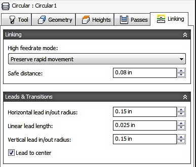

Linking tab settings
High feedrate mode:
Specifies when rapid movements should be output as true rapids (G0) and when they should be output as high feedrate movements (G1).
Preserve rapid movement - All rapid movements are preserved.
Preserve axial and radial rapid movement - Rapid movements moving only horizontally (radial) or vertically (axial) are output as true rapids.
Preserve axial rapid movement - Only rapid movements moving vertically.
Preserve radial rapid movement - Only rapid movements moving horizontally.
Preserve single axis rapid movement - Only rapid movements moving in one axis (X, Y or Z).
Always use high feed - Outputs rapid movements as (high feed moves) G01 moves instead of rapid movements (G0).
This parameter is usually set to avoid collisions at rapids on machines which perform "dog-leg" movements at rapid.
High feedrate:
The feedrate to use for rapids movements output as G1 instead of G0.
Safe distance:
Minimum distance between the tool and the part surfaces during retract moves. The distance is measured after stock to leave has been applied, so if a negative stock to leave is used, special care should be taken to ensure that safe distance is large enough to prevent any collisions.
Horizontal lead-in radius:
Specifies the radius for horizontal lead-in moves.
Horizontal lead-out radius:
Specifies the radius for horizontal lead-out moves.
Linear lead length:
Specifies the length of the linear leads.
Vertical lead-in radius:
The radius of the vertical arc smoothing the entry move as it goes from the entry move to the toolpath itself.
Vertical lead-out radius:
Specifies the radius of the vertical lead-out.
Lead To Center
When enabled the lead in/out movement will start from the center of the hole or pocket.
