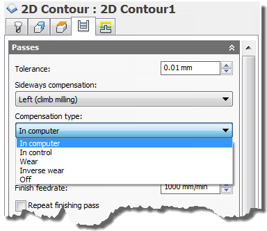

About Radius Compensation
You can select the type of compensation performed from the Compensation type drop-down menu on the Passes tab of the 2D Contour dialog box.
Changing the Compensation type
