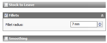

Inventor CAM provides a toolpath filleting function that is useful for avoiding sharp corners in 3D finishing toolpaths. With fillets applied, sharp turns in the toolpath can be reduced so that the CNC control can maintain a higher feedrate and/or prevent marks on the machined part.
The Fillets section and Fillet radius parameter are located on the Passes tab between the Stock to Leave and Smoothing sections
