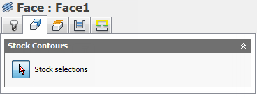

To set the machining area manually, simply click the Stock selections button on the Geometry tab and select the contours as usual.
Click the Stock selections button to manually select geometry
