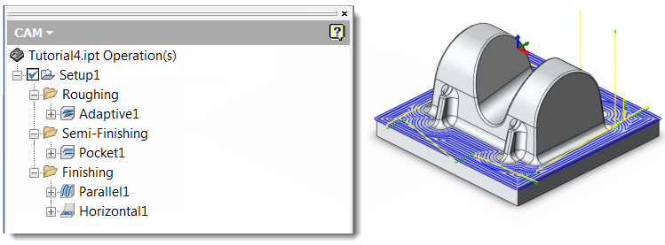

Unlike setups, folders do not affect the operations that they contain, but are useful for grouping operations. For example, a common scenario is to create separate folders for roughing, semi-finishing, and finishing operations.
A 3D part with folders for each group of operations. An open folder displays the operations within it.
