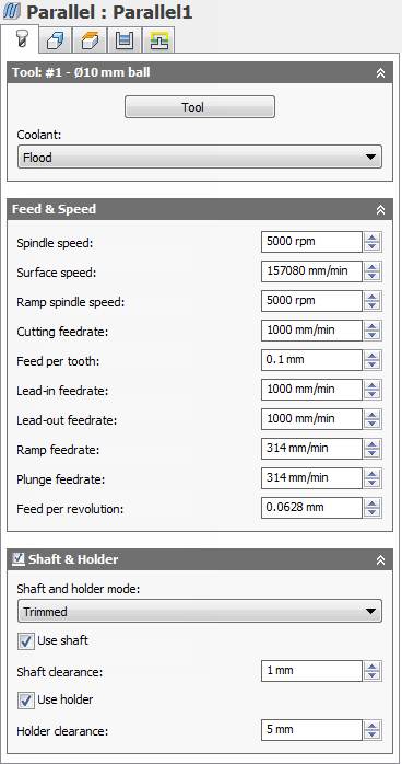

Select the type of coolant used with the machine tool. Not all types will work with all machine postprocessors.
Spindle and Feedrate cutting parameters.
When using a tool with a holder, you can choose between one of five different shaft and holder modes, depending on the machining strategy. Collision handling can be done for both the tool shaft and holder, and they can be given separate clearances.
Disabled
Pull away
Trimmed
Detect tool length
Specifies that the shaft of the selected tool will be used in the toolpath calculation to avoid collisions.
The tool shaft always stays this distance from the part.
Specifies that the holder of the selected tool will be used in the toolpath calculation to avoid collisions.
The tool holder always stays this distance from the part.

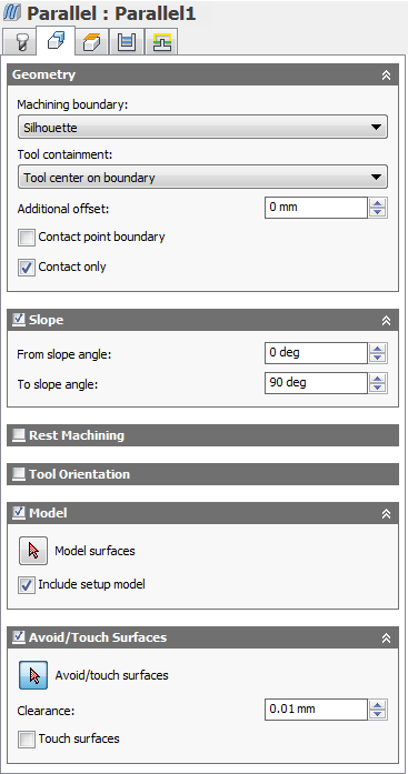

Boundaries mode specifies how the toolpath boundary is confined. The following images are shown using a 3D Radial toolpath.
![]() Example 1 Silhouette |
![]() Example 2 Selection |
![]() Bounding Box. |
![]() Silhouette. |
![]() Selection. |
Use tool containment to control the tools' position in relation to the selected boundary or boundaries.
Inside
The entire tool stays inside the boundary. As a result, the entire surface contained by the boundary might not be machined.
Center
The boundary limits the center of the tool. This setting ensures that the entire surface inside the boundary is machined. However, areas outside the boundary or boundaries might also be machined.
Outside
The toolpath is created inside the boundary, but the tool edge can move on the outside edge of the boundary.
![]() Inside |
![]() Center |
![]() Outside |
Use the Additional Offset parameter, to overlap the boundary edge.
The additional offset is applied to the selected boundary/boundaries and tool containment.
A positive value offsets the boundary outwards unless the tool containment is Inside, in which case a positive value offsets inwards.
![]() Negative offset with tool center on boundary |
![]() No offset with tool center on boundary |
![]() Positive offset with tool center on boundary |
To ensure that the edge of the tool overlaps the boundary, select the Outside tool containment method and specify a small positive value.
To ensure that the edge of the tool is completely clear of the boundary, select the Inside tool containment method and specify a small positive value.
When enabled, specifies that the boundary limits where the tool touches the part rather than the tool center location.
The difference is illustrated below on a Parallel toolpath using a ball end mill.
| Toolpath driven by Tool Center. | Toolpath driven by Tool Contact Point |
![]() Disabled |
![]() Enabled |
![]() Disabled |
![]() Enabled |
Controls whether or not toolpaths are generated where the tool is not in contact with the machining surface. When disabled, toolpaths are extended to the limits of the containment boundary and across openings in the workpiece.
![]() Enabled |
![]() Disabled |
When selected, contains toolpaths based on a range of specified angles.
Only areas equal to or greater than the values in the From Slope Angle and To Slope Angle parameters are machined.
Most 3D finishing strategies support slope angle confinement. One use of slope confinement is to confine a selected toolpath strategy to angles where it works best. For example, Parallel Finish is better suited to shallow areas while Contour Finish is better suited to steep areas.
![]() 0° - 90° |
![]() 0° - 45° |
![]() 45° - 90° |
From Slope Angle is defined from the 0° (horizontal) plane. Only areas equal to or greater than this value are machined.
To Slope Angle is defined from the 0° (horizontal) plane. Only areas equal to or less than this value are machined.
Slope angle confinement is defined from 0° (horizontal) to 90° (vertical).
![]() Slope angle from 0° |
![]() Slope angle to 90° |
When checked this limits the operation to only remove material that a previous tool or operation could not remove.
Rest stands for REmaining STock.
Specifies the source from which the rest machining is to be calculated.
Uses the stock body as defined in the Setup
Specifies the diameter of the rest material tool.
Selects the rest material adjustment for respectively ignoring or ensuring milling of small cusps.
This parameter specifies the amount of stock to be ignored, or additionally removed, depending on the Rest Material Adjustment setting. The parameter is primarily used to avoid machining of minor rest material with the Ignore cusps setting.
Specifies how the tool orientation is determined using a combination of triad orientation and origin options.
The Orientation drop-down menu provides the following options to set the orientation of the X, Y, and Z triad axes:
The Origin drop-down menu offers the following options for locating the triad origin:
Enable to override the model geometry (surfaces/bodies) defined in the setup.
Enabled by default, the model selected in the setup is included in addition to the model surfaces selected in the operation. If you disable this check box, then the toolpath is generated only on the surfaces selected in the operation.
When enabled, you can select surfaces to avoid. The toolpath will stay away from the selected surfaces by a specified amount.
![]() Disabled All surfaces are machined. |
![]() Enabled Selected surfaces are avoided. |
The tool always stays this distance from the selected surfaces.
Inverts the meaning of the Avoid surfaces setting. When enabled, the avoid surfaces are the ones that must be touched within the given clearance while the remaining surfaces are avoided.

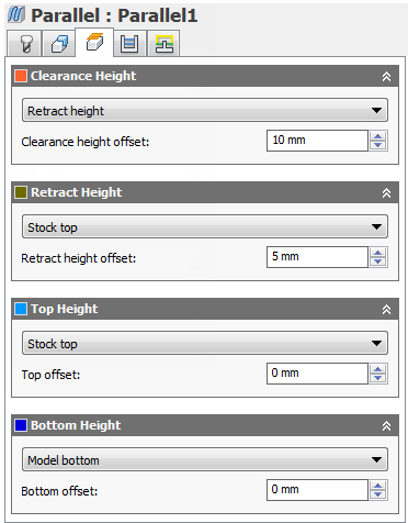

The Clearance height is the first height the tool rapids to on its way to the start of the tool path.
Clearance Height
The Clearance height offset is applied and is relative to the Clearance height selection in the above drop-down list.
Retract height sets the height that the tool moves up to before the next cutting pass. Retract height should be set above the Feed height and Top. Retract height is used together with the subsequent offset to establish the height.
Retract Height
Retract height offset is applied and is relative to the Retract height selection in the above drop-down list.
Top height sets the height that describes the top of the cut. Top height should be set above the Bottom. Top height is used together with the subsequent offset to establish the height.
Top Height
Top offset is applied and is relative to the Top height selection in the above drop-down list.
Bottom height determines the final machining height/depth and the lowest depth that the tool descends into the stock. Bottom height needs to be set below the Top. Bottom height is used together with the subsequent offset to establish the height.
Bottom Height
Bottom offset is applied and is relative to the Bottom height selection in the above drop-down list.

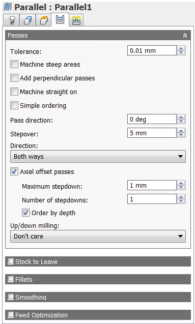

Specifies that extra passes will be added where the surface is steep perpendicular to the machining direction. This is important for plastic injection molds where the cutting direction needs to be consistent to avoid marks on the parts.
![]() Disabled |
![]() Enabled |
Defines the minimum stepover that is used when Machine steep areas is enabled, regardless of the stepdown amount.
Defines the maximum steep stepdown.
Enable to add a set of passes perpendicular to the specified machining direction to reduce machining cusps.
![]() Disabled |
![]() Enabled |
Avoids machining along the steep areas by automatically choosing the best direction for the parallel passes.
Enable to force simple ordering across the cutting direction instead of ordering by shortest distance. You can use this feature to avoid marks on the machined part in some cases. However, the machining time will be increased due to additional linking motion.
Specifies the direction of the passes.
![]() Pass direction @ 0° |
![]() Pass direction @ 45° |
Specifies horizontal stepover between passes. By default this value is 95% of the cutter diameter less the tool corner radius.
Horizontal Stepover
The direction option lets you control if Inventor CAM should attempt to maintain either Climb or Conventional milling.
Climb
Select Climb to machine all the passes in a single direction. When this method is used, Inventor CAM attempts to use climb milling relative to the selected boundaries.
Conventional
This reverses the direction of the toolpath compared to the Climb setting to generate a conventional milling toolpath.
Both Ways
When Both ways is selected, Inventor CAM disregards the machining direction and links passes with the directions that result in the shortest toolpath.
![]() Climb |
![]() Both Ways |
Enable to do multiple depth cuts.
Axial offset passes are used to create multiple incremental Z offset passes in many of the 3D finishing strategies. They work much like multiple finishing stepdowns in the 2D operations and are useful for removing a fixed amount of stock using several passes. The following images are shown with 3D Parallel.
![]() Disabled |
![]() Three axial offset passes |
Specifies the maximum stepdown between Z-levels for roughing.
Maximum Stepdown - shown without Finishing Stepdowns
Specifies the desired number of stepdowns.
Specifies that the passes should be ordered top down.
![]() Disabled |
![]() Enabled |
Use this option to break each pass into segments so that each piece is machined using either downward or upward moves only. This is useful when using insert cutters that are restricted to a specific cutting direction.
![]() Don't Care |
![]() Down Milling |

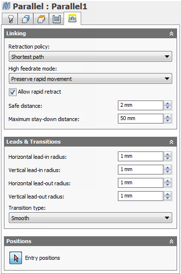

Controls how the tool moves between cutting passes. The following images are shown using the Flow strategy.
For CNC machines that do not support linearized rapid moves, the post processor can be modified to convert all G0 moves to high-feed G1 moves. Contact technical support for more information or instructions how to modify post processors as described.
Specifies when rapid movements should be output as true rapids (G0) and when they should be output as high feedrate movements (G1).
This parameter is usually set to avoid collisions at rapids on machines which perform "dog-leg" movements at rapid.
The feedrate to use for rapids movements output as G1 instead of G0.
When enabled, retracts are done as rapid movements (G0). Disable to force retracts at lead-out feedrate.
Minimum distance between the tool and the part surfaces during retract moves. The distance is measured after stock to leave has been applied, so if a negative stock to leave is used, special care should be taken to ensure that safe distance is large enough to prevent any collisions.
Specifies the maximum distance allowed for stay-down moves.
![]() 1" Maximum stay-down distance |
![]() 2" Maximum stay-down distance |
Specifies the radius for horizontal lead-in and lead-out moves.
![]() Horizontal lead-in radius |
![]() Horizontal lead-out radius |
The vertical arc smoothing radius it goes from the entry move onto the toolpath and off of the toolpath.
![]() Vertical lead-in radius |
![]() Vertical lead-out radius |
Specifies the type of connection done between passes.
Selection button to choose entry positions.
