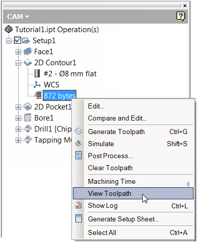

To View Toolpath Information
View Toolpath provides low-level information about the toolpath in a list format that, in some cases, can be more convenient than actually simulating the toolpath. It is available from the CAM Browser by right-clicking the toolpath component of an operation and selecting View Toolpath from the pop-up context menu.

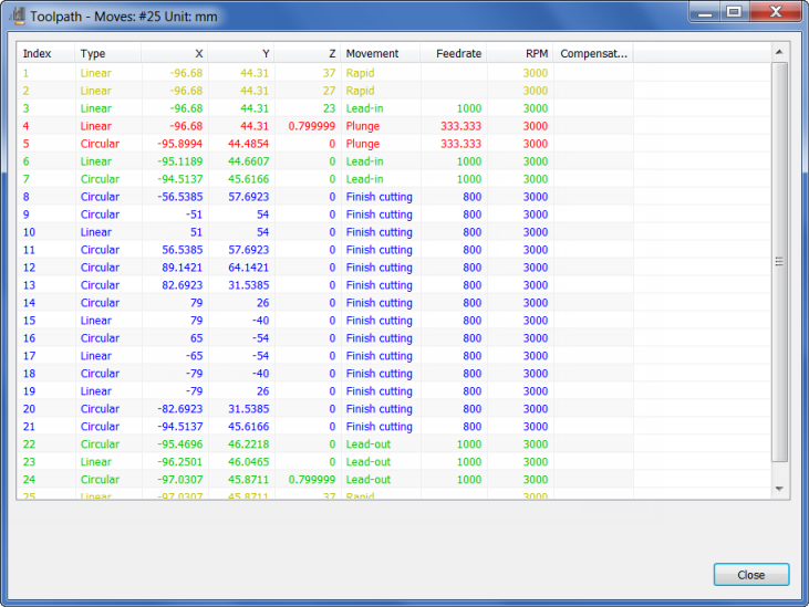

The View Toolpath dialog box shows information about the individual moves like feeds and speeds, movement types, tool compensation, and movement coordinates.
