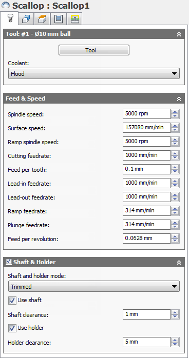

Select the type of coolant used with the machine tool. Not all types will work with all machine postprocessors.
Spindle and Feedrate cutting parameters.
When using a tool with a holder, you can choose between one of five different shaft and holder modes, depending on the machining strategy. Collision handling can be done for both the tool shaft and holder, and they can be given separate clearances.
Disabled
Pull away
Trimmed
Detect tool length
Specifies that the shaft of the selected tool will be used in the toolpath calculation to avoid collisions.
The tool shaft always stays this distance from the part.
Specifies that the holder of the selected tool will be used in the toolpath calculation to avoid collisions.
The tool holder always stays this distance from the part.

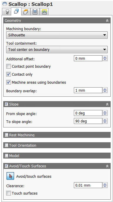

Boundaries mode specifies how the toolpath boundary is confined. The following images are shown using a 3D Radial toolpath.
![]() Example 1 Silhouette |
![]() Example 2 Selection |
![]() Bounding Box. |
![]() Silhouette. |
![]() Selection. |
Use tool containment to control the tools' position in relation to the selected boundary or boundaries.
Inside
The entire tool stays inside the boundary. As a result, the entire surface contained by the boundary might not be machined.
Center
The boundary limits the center of the tool. This setting ensures that the entire surface inside the boundary is machined. However, areas outside the boundary or boundaries might also be machined.
Outside
The toolpath is created inside the boundary, but the tool edge can move on the outside edge of the boundary.
![]() Inside |
![]() Center |
![]() Outside |
Use the Additional Offset parameter, to overlap the boundary edge.
The additional offset is applied to the selected boundary/boundaries and tool containment.
A positive value offsets the boundary outwards unless the tool containment is Inside, in which case a positive value offsets inwards.
![]() Negative offset with tool center on boundary |
![]() No offset with tool center on boundary |
![]() Positive offset with tool center on boundary |
To ensure that the edge of the tool overlaps the boundary, select the Outside tool containment method and specify a small positive value.
To ensure that the edge of the tool is completely clear of the boundary, select the Inside tool containment method and specify a small positive value.
When enabled, specifies that the boundary limits where the tool touches the part rather than the tool center location.
The difference is illustrated below on a Parallel toolpath using a ball end mill.
| Toolpath driven by Tool Center. | Toolpath driven by Tool Contact Point |
![]() Disabled |
![]() Enabled |
![]() Disabled |
![]() Enabled |
Controls whether or not toolpaths are generated where the tool is not in contact with the machining surface. When disabled, toolpaths are extended to the limits of the containment boundary and across openings in the workpiece.
![]() Enabled |
![]() Disabled |
When selected, contains toolpaths based on a range of specified angles.
Only areas equal to or greater than the values in the From Slope Angle and To Slope Angle parameters are machined.
Most 3D finishing strategies support slope angle confinement. One use of slope confinement is to confine a selected toolpath strategy to angles where it works best. For example, Parallel Finish is better suited to shallow areas while Contour Finish is better suited to steep areas.
![]() 0° - 90° |
![]() 0° - 45° |
![]() 45° - 90° |
From Slope Angle is defined from the 0° (horizontal) plane. Only areas equal to or greater than this value are machined.
To Slope Angle is defined from the 0° (horizontal) plane. Only areas equal to or less than this value are machined.
Slope angle confinement is defined from 0° (horizontal) to 90° (vertical).
![]() Slope angle from 0° |
![]() Slope angle to 90° |
When checked this limits the operation to only remove material that a previous tool or operation could not remove.
Rest stands for REmaining STock.
Specifies the source from which the rest machining is to be calculated.
Uses the stock body as defined in the Setup
Specifies the diameter of the rest material tool.
Selects the rest material adjustment for respectively ignoring or ensuring milling of small cusps.
This parameter specifies the amount of stock to be ignored, or additionally removed, depending on the Rest Material Adjustment setting. The parameter is primarily used to avoid machining of minor rest material with the Ignore cusps setting.
Specifies how the tool orientation is determined using a combination of triad orientation and origin options.
The Orientation drop-down menu provides the following options to set the orientation of the X, Y, and Z triad axes:
The Origin drop-down menu offers the following options for locating the triad origin:
Enable to override the model geometry (surfaces/bodies) defined in the setup.
Enabled by default, the model selected in the setup is included in addition to the model surfaces selected in the operation. If you disable this check box, then the toolpath is generated only on the surfaces selected in the operation.
When enabled, you can select surfaces to avoid. The toolpath will stay away from the selected surfaces by a specified amount.
![]() Disabled All surfaces are machined. |
![]() Enabled Selected surfaces are avoided. |
The tool always stays this distance from the selected surfaces.
Inverts the meaning of the Avoid surfaces setting. When enabled, the avoid surfaces are the ones that must be touched within the given clearance while the remaining surfaces are avoided.

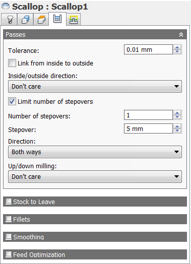

The tolerance used when linearizing geometry such as splines and ellipses. The tolerance is taken as the maximum chord distance.
![]() Loose Tolerance .100 |
![]() Tight Tolerance .001 |
CNC machine contouring motion is controlled using line G1 and arc G2 G3 commands. To accommodate this, CAM approximates spline and surface toolpaths by linearizing them creating many short line segments to approximate the desired shape. How accurately the toolpath matches the desired shape depends largely on the number of lines used. More lines result in a toolpath that more closely approximates the nominal shape of the spline or surface.
Data Starving
It is tempting to always use very tight tolerances, but there are trade-offs including longer toolpath calculation times, large G-code files, and very short line moves. The first two are not much of a problem because Inventor CAM calculates very quickly, and most modern controls have at least 1MB of RAM. However, short line moves, coupled with high feedrates, may result in a phenomenon known as data starving.
Data starving occurs when the control becomes so overwhelmed with data that it cannot keep up. CNC controls can only process a finite number of lines of code (blocks) per second. That can be as few as 40 blocks/second on older machines and 1,000 blocks/second or more on a newer machine like the Haas Automation control. Short line moves and high feedrates can force the processing rate beyond what the control can handle. When that happens, the machine must pause after each move and wait for the next servo command from the control.
Enable to specify whether the linking between passes should be done without particular ordering or linking should be done by ordering from inside passes to outside passes.
Specifies if the toolpath moves inside-out or outside-in. Selecting the Don't care option minimizes the ordering by distance.
Inside > out
Outside > in
When disabled, the number of steps is unlimited and the result is a collapsed pencil finish of the entire surface.
Specifies the number of roughing steps.
Specifies horizontal stepover between passes. By default, this value is 95% of the cutter diameter less the tool corner radius.
Horizontal stepover
The direction option lets you control if Inventor CAM should attempt to maintain either Climb or Conventional milling.
Climb
Select Climb to machine all the passes in a single direction. When this method is used, Inventor CAM attempts to use climb milling relative to the selected boundaries.
Conventional
This reverses the direction of the toolpath compared to the Climb setting to generate a conventional milling toolpath.
Both Ways
When Both ways is selected, Inventor CAM disregards the machining direction and links passes with the directions that result in the shortest toolpath.
![]() Climb |
![]() Both Ways |
Use this option to break each pass into segments so that each piece is machined using either downward or upward moves only. This is useful when using insert cutters that are restricted to a specific cutting direction.
![]() Don't Care |
![]() Down Milling |

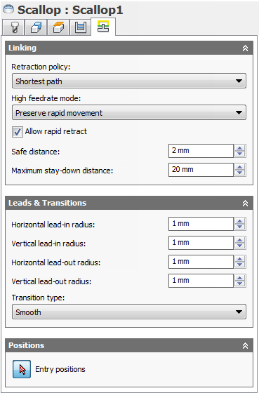

Controls how the tool moves between cutting passes. The following images are shown using the Flow strategy.
For CNC machines that do not support linearized rapid moves, the post processor can be modified to convert all G0 moves to high-feed G1 moves. Contact technical support for more information or instructions how to modify post processors as described.
Specifies when rapid movements should be output as true rapids (G0) and when they should be output as high feedrate movements (G1).
This parameter is usually set to avoid collisions at rapids on machines which perform "dog-leg" movements at rapid.
The feedrate to use for rapids movements output as G1 instead of G0.
When enabled, retracts are done as rapid movements (G0). Disable to force retracts at lead-out feedrate.
Minimum distance between the tool and the part surfaces during retract moves. The distance is measured after stock to leave has been applied, so if a negative stock to leave is used, special care should be taken to ensure that safe distance is large enough to prevent any collisions.
Specifies the maximum distance allowed for stay-down moves.
![]() 1" Maximum stay-down distance |
![]() 2" Maximum stay-down distance |
Specifies the radius for horizontal lead-in and lead-out moves.
![]() Horizontal lead-in radius |
![]() Horizontal lead-out radius |
The vertical arc smoothing radius it goes from the entry move onto the toolpath and off of the toolpath.
![]() Vertical lead-in radius |
![]() Vertical lead-out radius |
Specifies the type of connection done between passes.
Selection button to choose entry positions.
