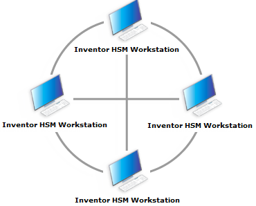

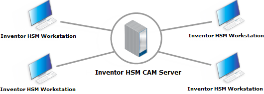

Distributed CAM allows you to utilize your workstations more efficiently. You can use Distributed CAM in different configurations as shown below.
Utilizing a single powerful workstation to speed up calculations on four other workstations
Sharing all workstations to speed up calculations
