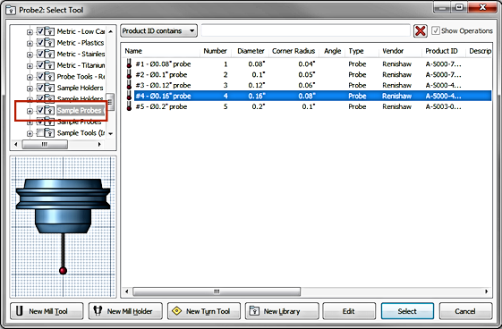

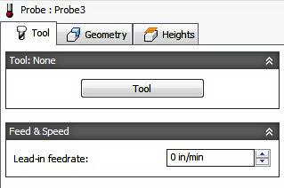

On the Tool Tab, press the Tool button and scroll down to theSample Probes library to select a probe. ![]() Press Select after making your selection. ![]() Lead-In Feedrate controls how fast the probe will move towards the part. |

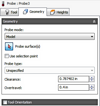

On the Geometry Tab you can select from the Model or Stock for your faces to probe. Selecting 1 wall will create a single axis probing function. Selecting the top face may provide additional probing options. The Faces you select determine the type of Probing you can perform. Keep in mind, you dont have to be on the Geometry Tab to select the probing face.

When enabled, forces probing at the actual point picked on the selected surface. The red arrow in the image below shows the User Selected Point for the selected surface.
Shows the available Probe Cycles based on your selection. Probe Mode and your Face selection determines the type of probing that can be performed.
The distance to position away from the selected face. By default, Clearance is set to 2 x the probe diameter
Sets the probe spacing between points when an Angle is being calculated from the selected face.
![]() Spacing of 1.5 in. |
![]() Spacing of 3.0 in. |
is the maximum distance to move past the selected wall before it stops probing. This is to prevent breaking the probe or stop it if there is no contact with the wall/face.

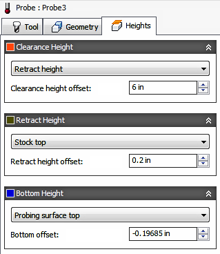

Select the positioning heights of the spindle axis.
Clearance Height is the position of the highest point, where the probe should rapid. The Probe cycle will start and end at this height. Shown in Orange, in the graphics area. ![]() Retract Height is an intermediate position above the part before, it moves to the final depth. If the probing cycle needs to probe several location, this is the height it moves to between probing. Shown in Dark Green, in the graphics area. ![]() Bottom Height is the depth where probing will start. This value is to the contact point of the probe. By default a spherical (ball) type of probe will be offset up by it's radius. Shown in Blue, in the graphics area. ![]() Offset for all of these, is an incremental shift, in reference to the selection shown for each Height. |
The Clearance height is the first height the tool rapids to on its way to the start of Probing and the point it returns to after the process is finished. This position can be defined in reference to the Stock, the Model, another Reference Height or a user selected position.
Clearance Height
The Clearance height offset is a shift relative to the Clearance Height selection. Enter a value, or drag the orange ring in the graphics area.
Retract height position sets an intermediate height between the Clearance and the Bottom height positions, used between probing moves. Retract height is used together with the Offset to establish the height.
Retract Height
Retract height offset is a shift relative to the Retract Height reference selection. Enter a value, or drag the dark green ring in the graphics area.
Bottom height determines the reference for the final probing depth. This reference and the Offset value establish the true probing depth. This position is to the contact point of the probe, not the bottom of the probe tip.
Bottom Height
Bottom offset is a shift relative to the Bottom Height reference selection. Enter a value, or drag the blue ring in the graphics area.
