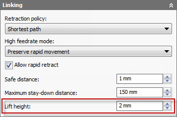

The Lift height setting is available for the 2D and 3D Pocket, Adaptive Clearing, and Horizontal Clearing strategies on the Linking tab.
