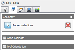

The default settings for Slot allow it to ramp to the final depth. Select the lower edge or sketch that represents the slot.
![]() Geometry selection for a Slot operation |

Slot can be used on any Edge or Sketch that represents a slot shape.
Closed or open boundaries can be machined by selecting Edges or Sketches. The Slot shape can be straight, circular or contain multiple curves. But it must be a continuous width slot shape.

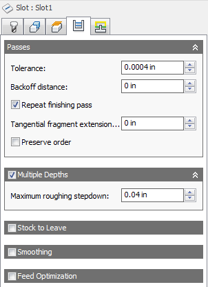

The tolerance used when linearizing geometry such as splines and ellipses. The tolerance is taken as the maximum chord distance.

After reaching the end of the cut, the tool will back off from the wall before retracting.

When checked the tool makes an additional cut to remove any stock left from tool deflection.

Specifies the tangential extension of the passes on open slots
Specifies that features are machined in the order in which they were selected. When unselected, Inventor CAM optimizes the cut order.
The default for Slot is to ramp to the depth. This will zig-zag to the full depth. One way to reduce the tool load is to take multiple depth cuts.

Specifies the maximum stepdown between Z-levels for roughing.

Controls the amount of material to leave in the axial direction (along the Z-axis), i.e. at the end of the tool. Using a negative stock value removes more material from the floor of the slot.
Smooths the toolpath by removing excessive points and fitting arcs where possible within the given filtering tolerance.

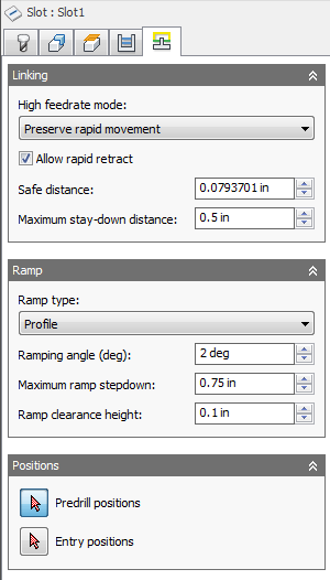

Specifies when rapid movements should be output as true rapids (G0) and when they should be output as high feedrate movements (G1).
This parameter is usually set to avoid collisions at rapids on machines which perform "dog-leg" movements at rapid.
The feedrate to use for rapid movements output as G1 instead of G0.
When enabled, retracts are done as rapid movements (G0). Disable to force retracts at lead-out feedrate.
Minimum distance between the tool and the part surfaces during retract moves. The distance is measured after stock to leave has been applied, so if a negative stock to leave is used, special care should be taken to ensure that safe distance is large enough to prevent any collisions.
Specifies the maximum distance allowed for stay-down moves.

Specifies how the cutter moves down for each depth cut.

Profile follows the slot shape. This is the default Ramp Type. The tool will ramp at the specified angle for the length of the slot. Reaching the full depth may require multiple zip-zag ramp moves. You can limit the depth of the ramp using the Maximum Ramp Stepdown |
Specifies the maximum ramping angle.
Specifies the maximum ramping depth when using the Profile - Ramp Type on long slots. This will limit the tool load for very deep or very short slots.

The height over the stock where the ramp toolpath start.
Select the points where holes have been drilled to provide clearance for the cutter to enter the material. Used with Predrill - Ramp Type.

Select geometry near the location where you want the tool to enter.
