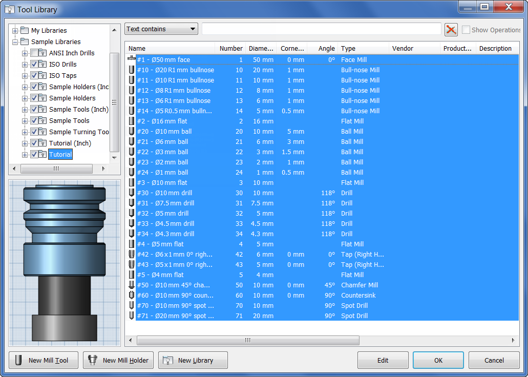

  1. Select some tools that you want to edit.
    Selecting tools to copy
  2. Copy these to the clipboard by right-clicking and selecting Copy, or by pressing Ctrl+C.
