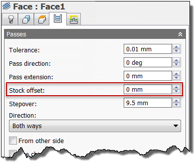

The Face strategy allows you to specify an additional offset for the automatic or manual stock contours by means of the Stock offset setting.
The Stock offset setting on the Passes tab
The selected or automatic stock contours are offset outwards by the amount specified.
