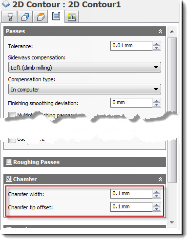

To create the chamfer, simply create a 2D Contour operation and make sure that a ball/bull end mill tool is selected.
Chamfer parameters for a ball mill tool

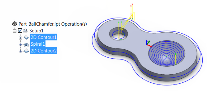

In the following part, the spherical indent is created using a ball end mill, and afterwards the 90 degree edges are chamfered using the same tool.
Example using a ball end mill for chamfering
