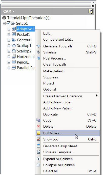

To Add Notes
You can add notes for each operation by choosing Edit Notes from the right-click pop-up context menu in the CAM Browser. The notes can be output in the generated setup sheets or NC programs. The notes are generally used to convey important information to the CNC operator. The HTML setup sheet includes notes by default. Most generic posts need to be updated to include notes.
Choosing Edit Notes from the pop-up context menu
