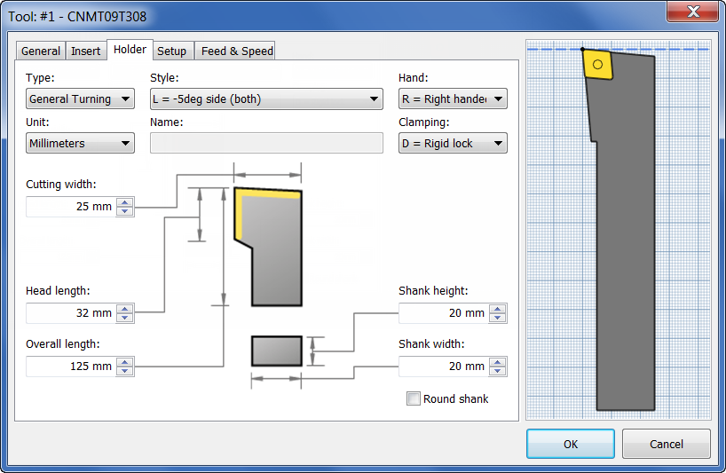

Holder tab settings
Type:
The type of the tool.
Unit:
The tool unit (Millimeters or Inches).
Style:
Specifies the shape of the holder.
Hand:
The side of the tool with respect to the part.
Clamping:
Specifies how the insert is fixed to the holder.
Cutting width:
The width of the holder head.
Head length:
The length of the holder head.
Overall length:
Specifies the entire length of the holder.
Shank height:
The height of the holder shank.
Shank width:
The width of the holder shank.
Round shank
Enabling this option specifies a cylindrical shank for the holder.

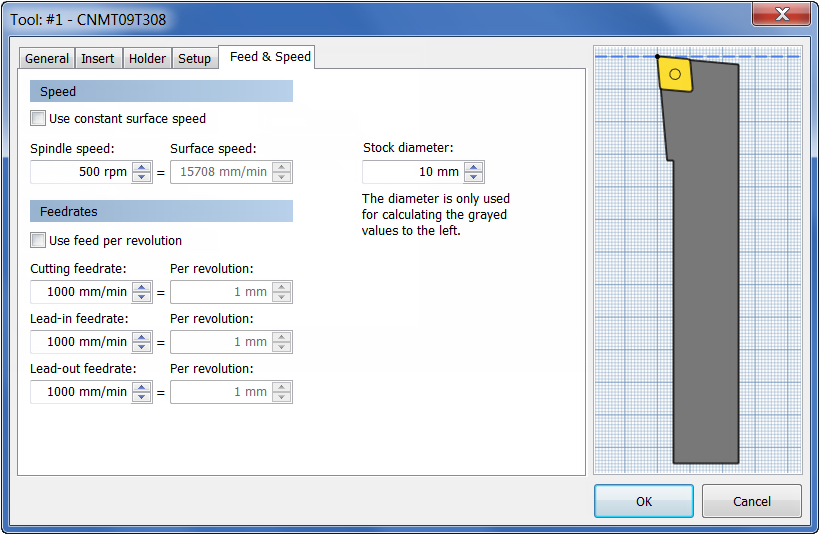

Feed & Speed tab settings
Speed
Use constant surface speed.
Spindle speed:
The rotational speed of the spindle.
Surface speed:
The spindle speed expressed as the speed of the tool on the surface.
Feedrates
Use feed per revolution.
Cutting feedrate:
Feed used in cutting moves.
Lead-in feedrate:
Feed used when leading in to a cutting move.
Lead-out feedrate:
Feed used when leading out from a cutting move.
Diameter:
The diameter of the cutter.
