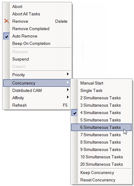

When regenerating multiple tasks, Inventor CAM automatically starts a number of jobs simultaneously. These jobs correspond to the number of CPU cores in your system, since this normally gives the best performance. Should you wish to change this behavior, you can do so by right-clicking on the task list and choosing a different Concurrency setting.
Changing the number of simultaneous tasks

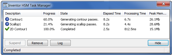

Inventor CAM obeys this limit when starting tasks automatically, but you can always start additional tasks manually, by clicking the Resume button in the Task Manager dialog box. This is useful when you have a number of larger tasks running, but have created additional tasks that you wish to calculate right away and not wait for the already running tasks to complete.
Forcing a pending task to start
The 2D Contour task is completed ahead of the 3D tasks

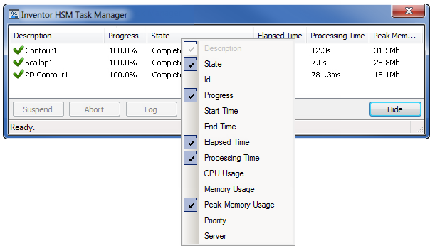

Notice from the screen images shown that additional columns are visible - Processing Time and Peak Memory. These, and additional options, can be enabled by right-clicking over one of the visible column headers.
Selecting visible columns in the task list
