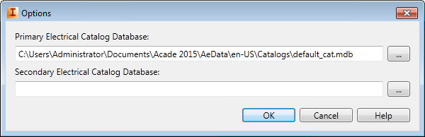

Define the primary catalog database.
The Electrical Catalog Browser defaults to the default_cat.mdb file installed with AutoCAD Electrical. You may want to reference a different catalog database from the Electrical Catalog Browser, for example a project specific catalog database.
Click the browse button next to the Primary Electrical Catalog Database edit box.
