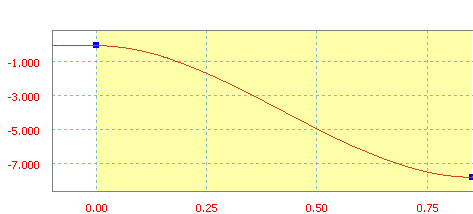

    Linear ramp, Cubic ramp, Cycloid, Harmonic, Modified sine, Modified trapezoid
    The coordinates (X1, Y1) and (X2, Y2) of the points that define the curve and/or enter a value for Slope to set the average gradient of the line. The curve can be defined either by entering the coordinates of the start and endpoints or by entering the coordinates of the start point and the average gradient of the sector.
    The curve is symmetrical about the middle of the sector.
    The area under the curve is equal to the area of the triangle beneath an equivalent linear ramp.
    Linear ramp has a constant slope, that is, the two points of the sector are linked by a straight line.

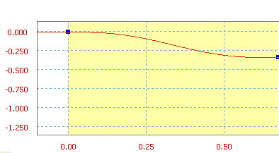

    Cubic ramp is defined by a 3rd order polynomial.
    Cubic ramp with an average slope of 70 in/s.
