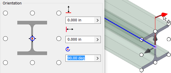

You can now interact with in-canvas manipulators when you insert or change a frame member.

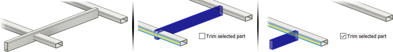

A Trim selected part checkbox is added that lets you select the side you want to keep.
The following image shows the effect of using the new option.
