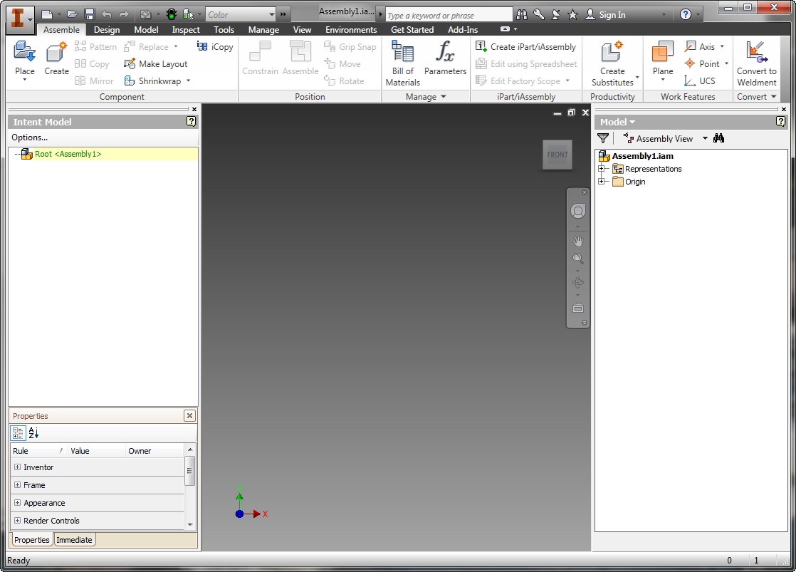

An empty Intent model is created:
Note: While you can have multiple Inventor models (parts and assemblies) open at the same time, you can only have one Intent Model open at a time. It is possible to create or open an assembly with an Intent model while another Intent assembly is open. In that case, a message displays where you verify which file to open.
