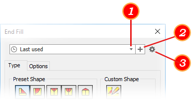

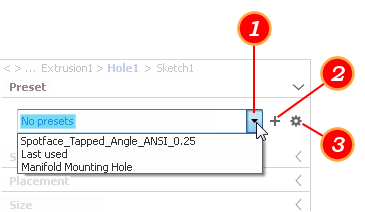

Preset Interface
  1. Drop down list of presets.
  2. Creates a new preset from the current parameters. A default name is provided, but can be changed.
  3. Preset Settings, which includes
    1. Save Current - save the current settings to a preset you name or use the default name.
    2. Rename Current - provide a different name for the current preset. When renaming a preset, you can use the Esc key to exit the process and restore the previous name.
    3. Delete Current - select the preset you want to delete, then click Delete Current.

Creating New Presets
When a command is activated, the property panel displays.
  1. If a feature of that type was previously created, the Preset field displays "Last Used". The panel values are populated with the last used values. If it is the first time a feature of that type is created, the field displays "No Preset".
  2. Modify the feature parameters in the property panel.
  3. Click Create new preset and specify the preset name or press Enter to accept the default name.
