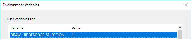

Environment Variable
The default hidden line behavior for a selected body is to not display the hidden lines. To display hidden lines in selected bodies, create an Environment Variable named DRAW_HIDDENEDGE_SELECTION and set the Value to a non-zero value.
