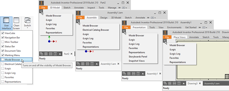

Access
Regardless of the document type, whenever the model browser is not displayed, you will see this icon
in the upper left of the graphics display. Click the icon to show the available browser panels for the active document.
You can also change the model browser visibility by going to the View tab
Windows panel
Switch drop-down list.
