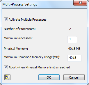

- Task Scheduler support multiple processes to shorten migration time. In the Settings menu, click Multiple Processess… button to open Multi-Process Settings dialog, See figure 1.
Figure 1

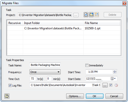

- Add files: Selecting this button displays a browser where you can select one or more files to migrate. This is a handy option to use when you wish to quickly migrate a small number of files such as your customized Inventor templates. See Figure 6.
Figure 6

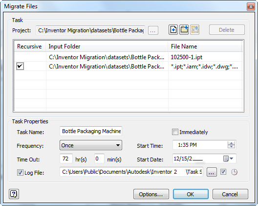

- Add folder: Select this button if you store your files on a single drive under a single top-level folder (perhaps, with subfolders). All files in the directory will migrate in the proper order. the order is part, assembly, drawing. See Figure 7.
Figure 7
