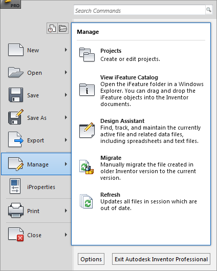

To use the Migrate command:
> Manage > Migrate. The Migrate command is available only if the current file is not yet migrated.
