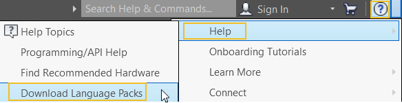

Installing Language Packs for Autodesk Inventor and LT
Language Packs for Autodesk Inventor and LT are not on the product media. Language Pack installers are available for download from the Inventor help menu:
Language pack installer screen
