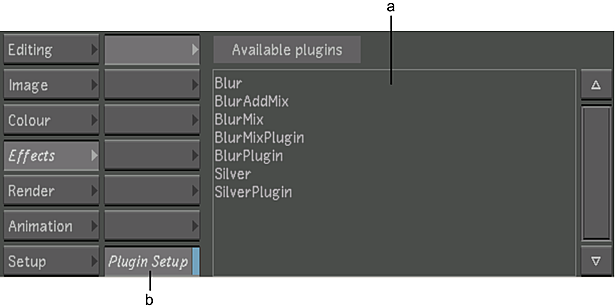

    Click Effects, and then enable Plugin Setup.
    (a) Available plugins list  (b) Plugin Setup button  
    The Available plugins list appears.

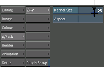

  2. Select Blur from the plugin list, and then set the kernel Size to 50.
  3. Click Anim, and then click Add.
    A keyframe is added at the current frame. When adding keyframes in this way, the interpolation type is always set to Bezier. To change it, you have to use the Interpolation controls in the Animation menu.
  4. Scrub to the last frame of the shot.
  5. Set the Kernel Size to 0.
  6. Click Add again to add another keyframe.
