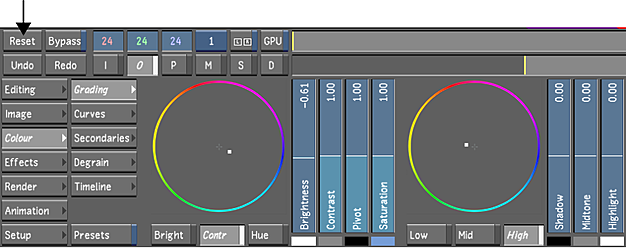

To reset all parameters for a menu:
  1. Select the shot you want to reset.
  2. Access the menu you want to reset.
  3. Click Reset, and then confirm.
    The menu is reset.
