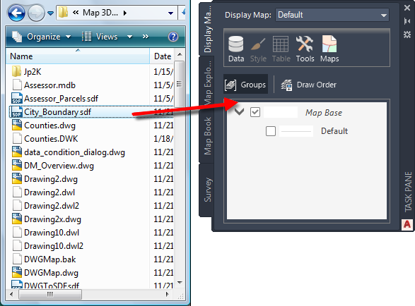

  4. Add the city boundaries to your map by dragging and dropping a source file to Display Manager.
    • Use Windows Explorer to navigate to the folder where you copied the sample files for the Build A Map tutorial.
    • Resize the AutoCAD Map 3D toolset window and your sample data folder window so you can see both of them at the same time.
    • Drag and drop the City_Boundary.sdf file onto the Display Manager, just above the Map Base layer.
      Drag and drop the city boundary file to Display Manager.
      The Redding city boundaries appear in your map.
