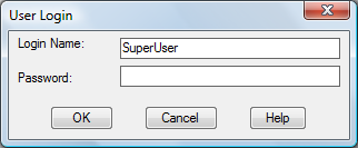

To log in as SuperUser
  1. Click Map Setup tabMap panel FindUser Login. Find
  2. Do one of the following:
    • If you have not changed the SuperUser login, specify the default login name SuperUser and the password SUPERUSER, using the capitalization shown. (Login is case sensitive.)
      Log in as SuperUser to define object classes.
    • If you changed the name or password for SuperUser, type your new information.
  3. Click OK.

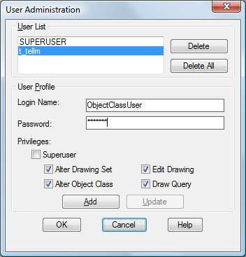

To create a user
  1. Click Map Setup tabMap panel FindUser Administration. Find Click Map Setup tabMap panel FindUser Administration. Find
    If someone else in your organization is the designated SuperUser, ask that person to do these steps.
    Find
    If you cannot log in as SuperUser, log in as a new user with the privileges to create object classes.
  2. Specify a new user name and password.
  3. Assign all privileges except SuperUser to the new user and click Add.
  4. Click OK.
