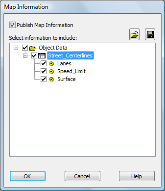

  3. In the Map Information dialog box, select Publish Map Information.
  4. In the Map Information dialog box, expand the items in the list and select Street_Centerlines.
    When you select Street_Centerlines, everything under Street_Centerlines is automatically selected.
  5. To publish the information to an XML file, click the save icon and specify a location for the published file. Click Save.
    The DWF Publish operation uses the XML file.
  6. Click OK.
