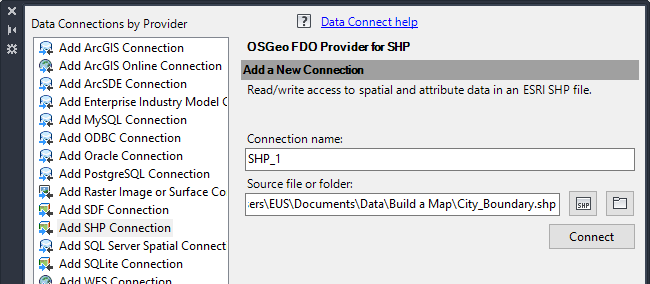

    • Switch the Task Pane to Display Manager.
    • Click Data and choose Connect To Data.
    • In the Data Connect window, under Data Connections By Provider (on the left), select Add SDF Connection.
    • Under Source File (on the right), click the browse button and navigate to the sample City_Boundary.sdf file. Click Connect.
      Use the Data Connect window to add a feature to the map
    • Under Schema, click Add To Map.
  3. Add the road data to your map.
    • In the Data Connect window, under Data Connections By Provider (on the left), select Add SHP Connection.
    • Under Source File (on the right), click the browse button and navigate to the sample Roads.shp file. Click Connect.
    • Click Add To Map.
    • Close the Data Connect window.
