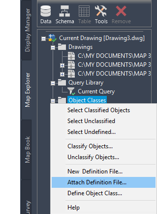

  2. Attach the object definition file by right-clicking Object Classes on the Map Explorer tab of the Task pane and clicking Attach Definition File.
    Attach the MyDefinition.xml definition file.
  3. Select the MyDefinition.xml definition file you created and click Open.

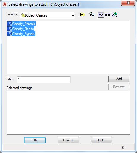

  5. Navigate to the folder where you saved the tutorial data. Hold down the Shift key, click the following drawings, and click Add:
    • Classify_Signals.dwg
    • Classify_Roads.dwg
    • Classify_Parcels.dwg
    Select all three drawing files.
  6. Click OK.
