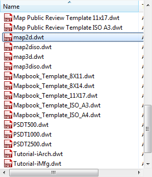

  4. In the Select Template dialog box, select map2d.dwt and click Open.
    Select map2d.dwt
    This file is an AutoCAD template that is set up to work with two-dimensional maps in AutoCAD Map 3D toolset.
